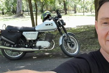

ETZ250
 MZ ETZ 250 (1981-1989, 239.417 db)
